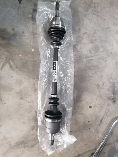

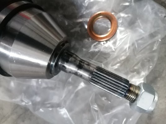

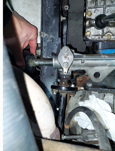

Nedd to change this rubber bellow of the wheels side..
Let's update the work already done..

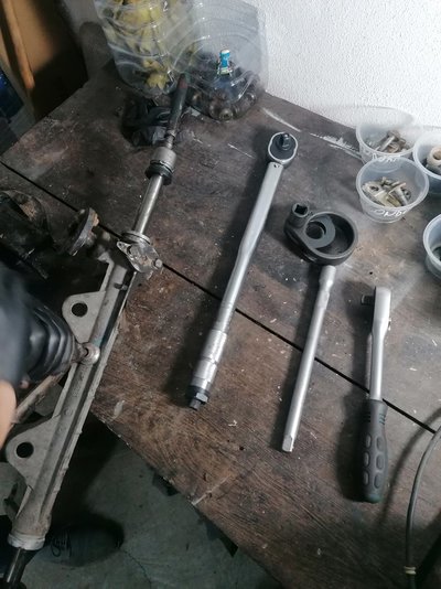

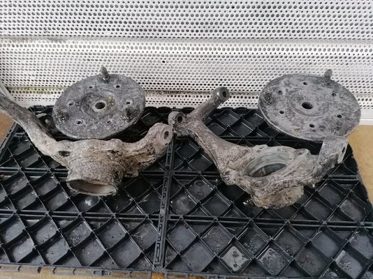

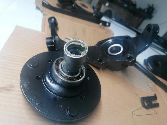

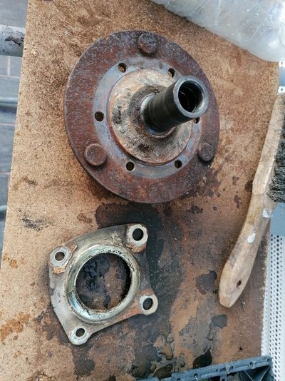

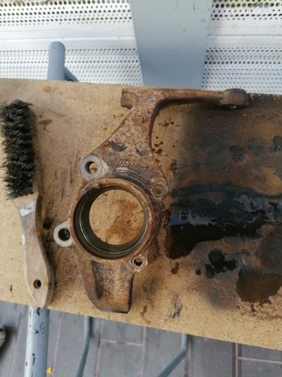

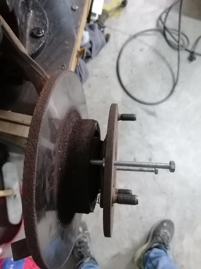

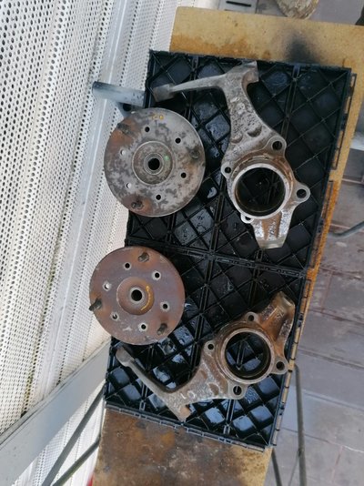

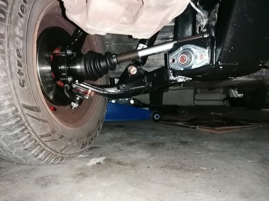

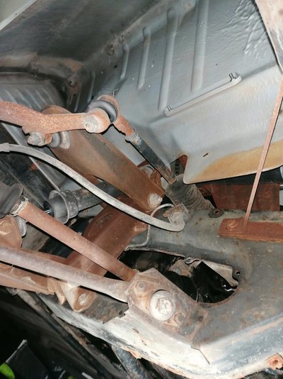

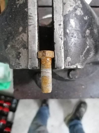

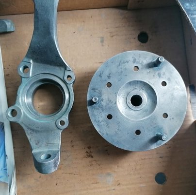

After desembling everything of the steering, I start removing the rust
Part of this work is already described in a post about rust remover.
I used phosphoric acid, a wire brush, sandpaper and a lot of patience. For painting I used an anti corrosive primer and high temperature paint.
Before
During
After

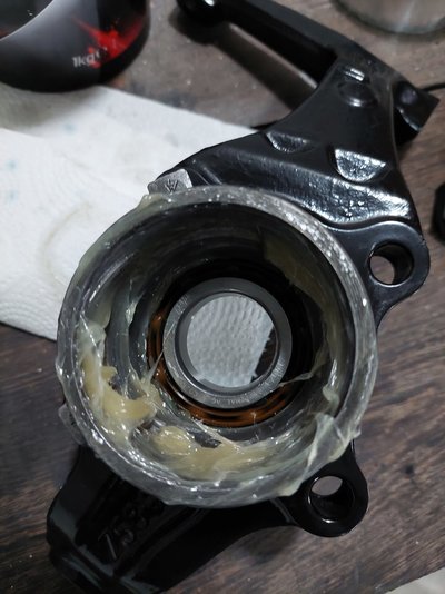

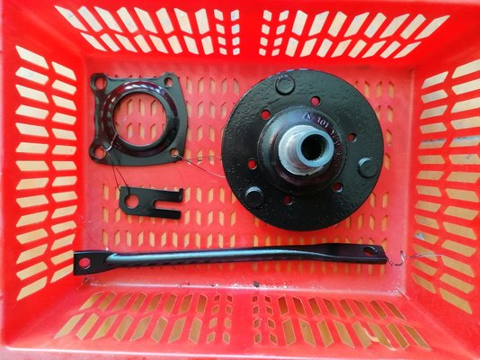

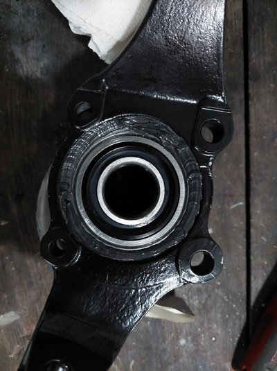

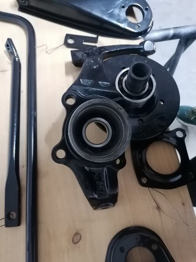

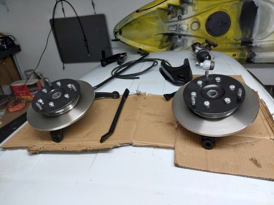

Today the work continued..

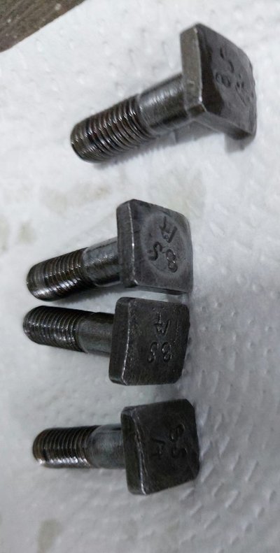

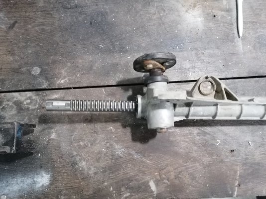

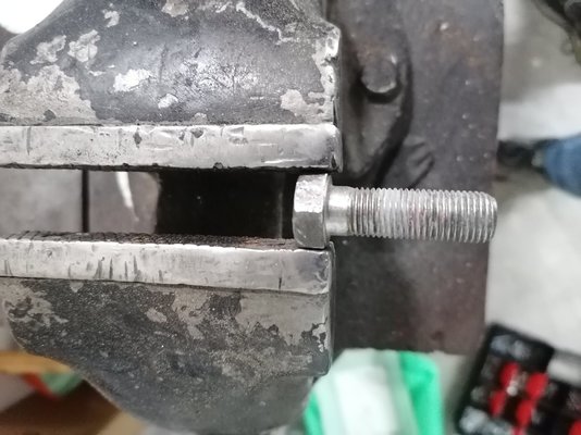

Some screw restoration.. don't have the final result
From this ones I don't have the "before"

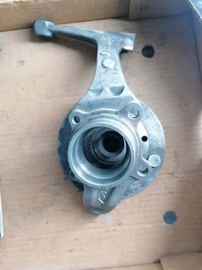

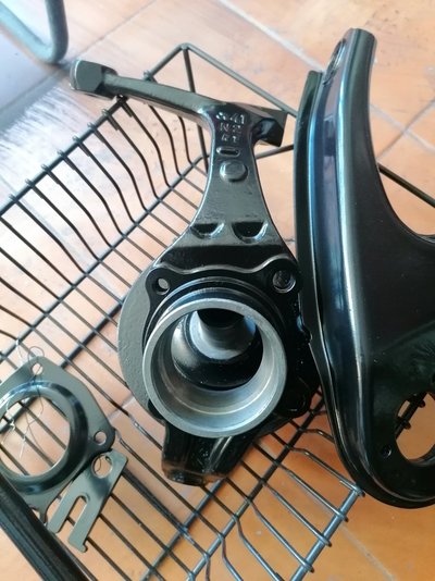

Let's start assembly the parts..
Now I need finish the paint of the arms..
I sugest that you send bolts to galvanising, as you have taken off protection coat.
They could rust (at surface) fast.

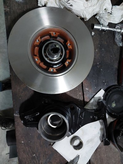

Last days in 2021..

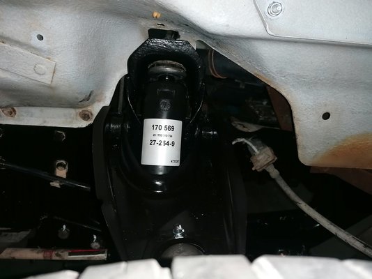

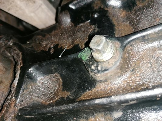

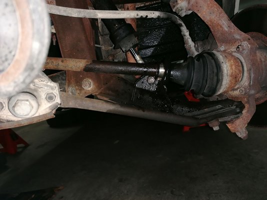

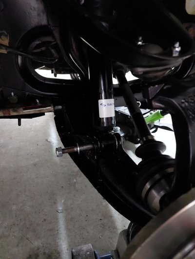

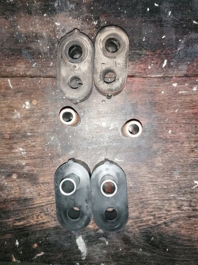

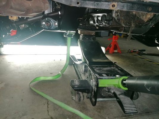

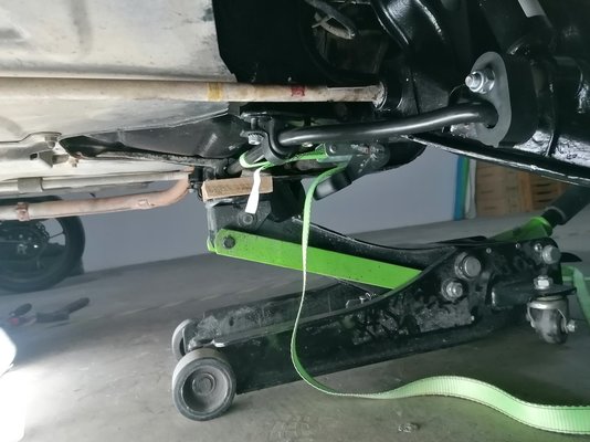

After recommendation I take of the shock absovers and put the new rubbers on it..
For someone who don't know anything of this, everything is a challenge.. put the anti-roll bar on the spot was very hard, Thanks to @petak for all the tips!!
So after many tries without good results, I stopped and do some reflexion..
The measure of the holes are 12mm and the originals are 10mm, so let's swap it..
After some pushes.. something happens eheh

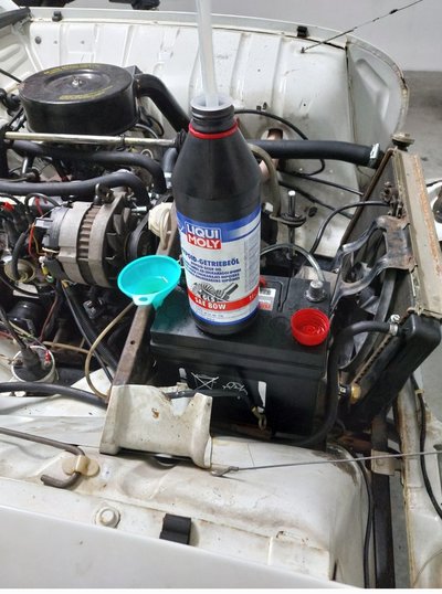

Gearbox oil refill.. 1.8l

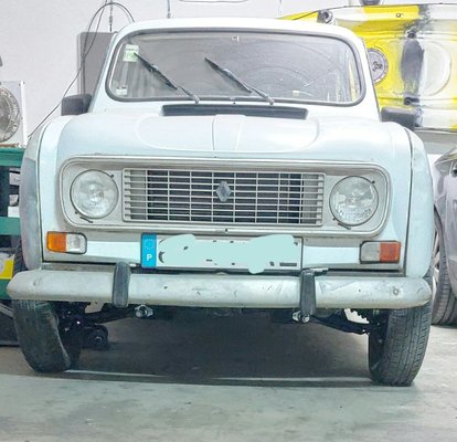

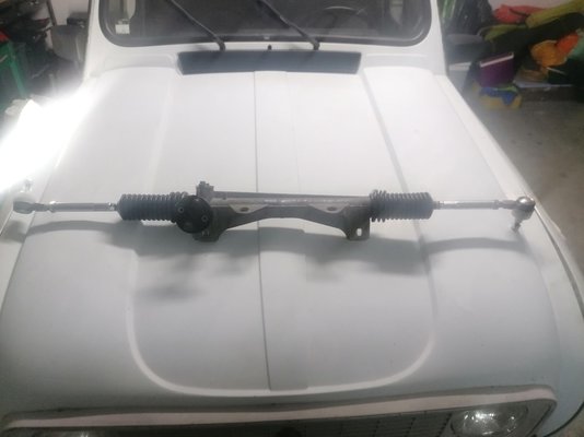

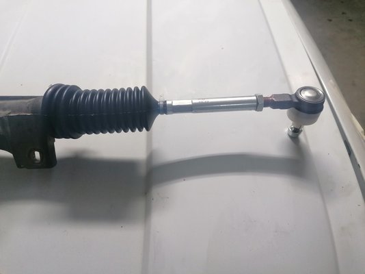

Let's try but the wheels/steering straight..
Steering position on the "marks" with aprox. 71.5cm to each side.
Steering wheel aligned..
But I need to do some check on the Steering arm for passenger side, the wheel are too much open..
After this adjust I will try drive to a professional alignment workshop..
I am happy that you made it.
Alighn wheels as much as possible so.you can drive it and then streight to wheel alighment specialist.
Spotless work but alignment and angle of the wheels are way off...
I've never seen wheels at that angle before.
I believe after adjust the measure on the Steering arm, the angle will be more normal. My big mistake wasn't mark the old mesure. @malcolm Do you have any other recommendation?
Try rolling the car a couple of metres. The positive camber might just be because the car has been lowered from a jack.
For setting tracking measure the distance between the rear of the front wheel rims and then the front of the rims (inside edges while the car is on the ground). If the front measurement s maybe 1 or 2mm larger than the rear measurement then it'll be close to right.
