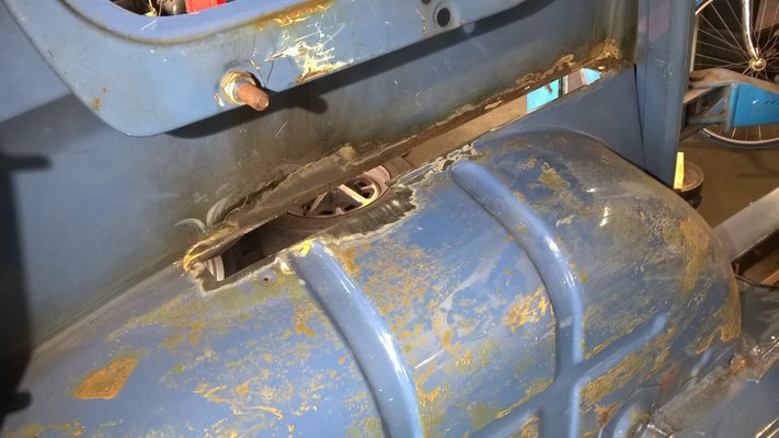

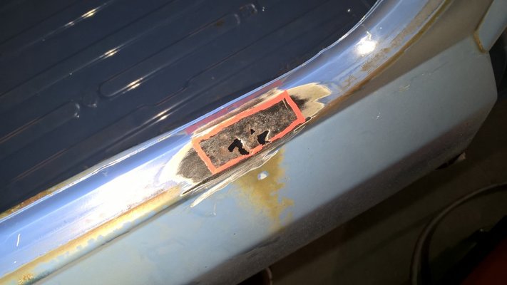

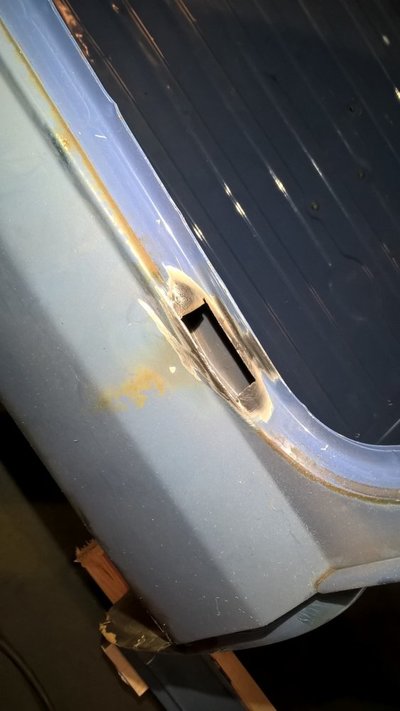

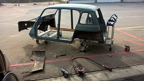

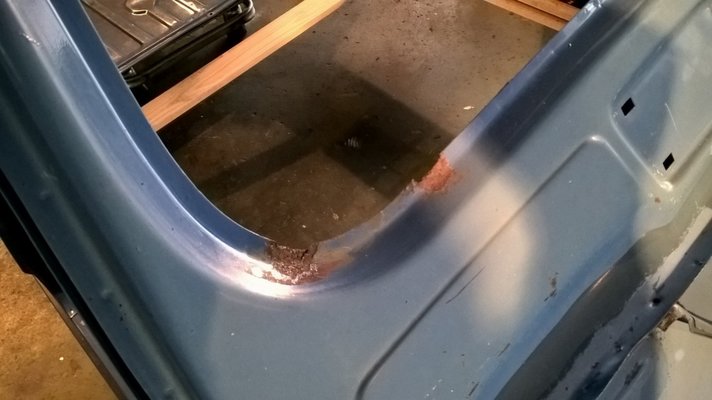

I also started working on the body! It took me 2 hours the get the side rear panels of... But it all seems in pretty good condition. Offcourse some minor welding needs to be done, but it is a very solid base to start with.

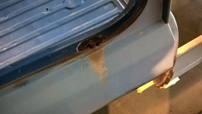

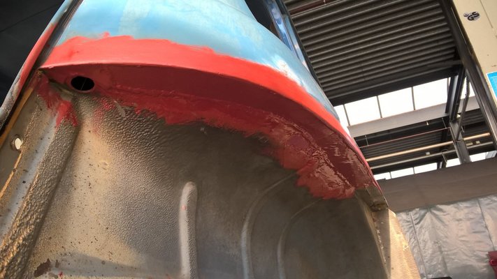

Jurjenz I've just caught up with your video. Great intro and so good to put a face to a name. Your engine sounds great and some very nice work so far. Body shell looks very good too . Be careful though when you scrape some of the rust off on the top insides of the rear wheel arches as its easy to slip and Mark the body just above the wheel arch. Thoroughly check those seat belt fastenings too as they are double skinned and rust from the inside. I wonder how good your rear corners are where the boot floor meets the wheel arches? These were the trickiest part repair on my car. That's a lovely blue colour by the way. Do you intend to keep it blue? Oh and sorry for all this advice - make sure you don't leave any glass in the body or stored nearby where you will likely be using an angle grinder with a cutting disc. The sparks from cutting and grinding will make permanent marks on the glass if it touches it :flame:

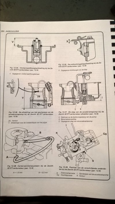

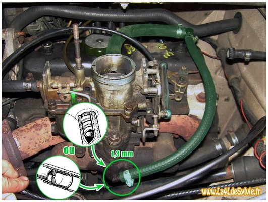

About the engine, Harbourseal pointed out that the restriction in the vacuumhose should have a diameter of 1,3 mm. I put one in with a diameter 1,5 mm, so I will make a new one and see what happens. Sometimes it is just difficult to know what is true..
The Haynes manual says 1,5 mm
Lasylvie.fr i.e. says 1,3 mm

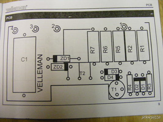

I also decided to buy a Velleman K2543 ignition set to improve the ignition. An affordable & useful improvement. 02nov11-1a.jpg Knipsel.JPG

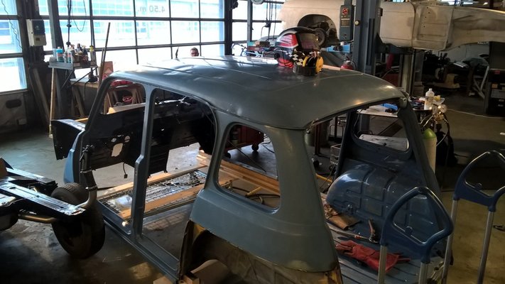

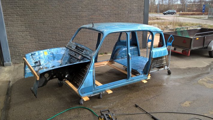

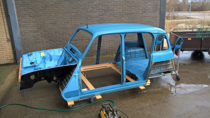

It was really satisfying to give the body a good cleaning! Love the colour! :laughing:
:cool::cool::cool::cool::cool::cool:
Looks remarkably good - agreed great colour too :cool: I see you've done the Wood Trick too! Keeping the front end together. Do be careful though as there is a lot of strain on the top inner wing where it meets the bulkhead and could split if the front isn't supported

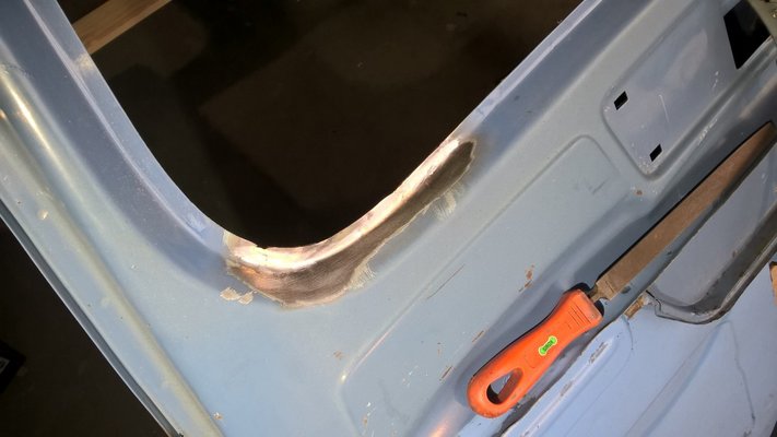

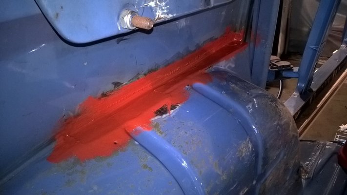

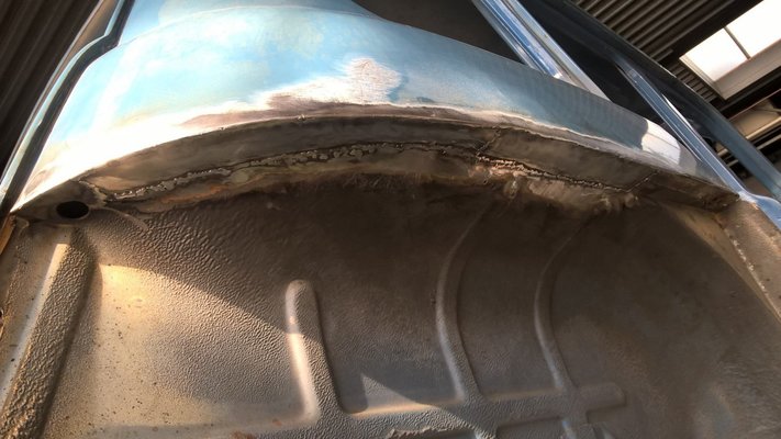

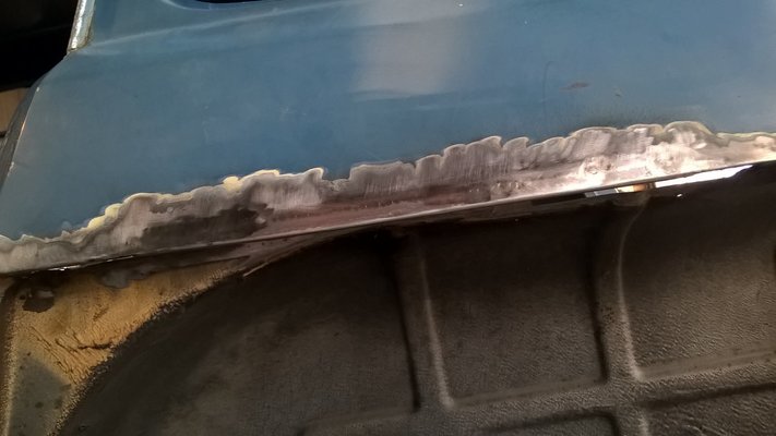

I especially like the repair that you did to the corner of the front windscreen. Very neat and clean finish.

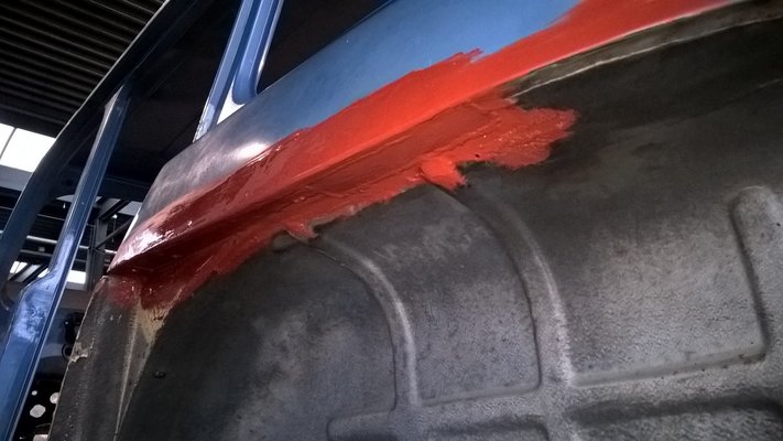

Nice welding job on the various body spots I'm sure the final result will be stunning and of course the help from the Cebora MIG welder :D

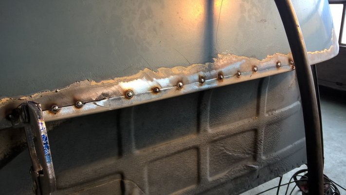

Ah the welding is for a different project where functionality and durability are much more important than looks. Its great fun and very addictive. Mig welding you say. ...

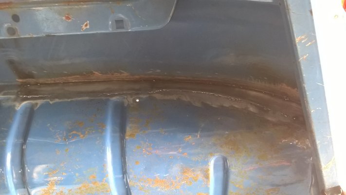

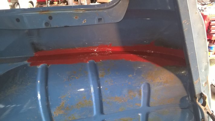

Mig welding is absolutely much fun! If you want weld on R4´s, use only 0,6 mm welding wire. I ran out and gave a a try on 0,8mm, terrible.. :welder:
17972090_1911008499132997_8035750367631262194_o.jpg WP_20170319_15_05_53_Pro.jpg WP_20170331_16_31_35_Pro.jpg WP_20170331_16_31_41_Pro.jpg WP_20170331_16_31_47_Pro.jpg WP_20170331_16_45_09_Pro.jpg WP_20170331_16_45_23_Pro.jpg WP_20170331_16_45_31_Pro.jpg WP_20170331_16_45_58_Pro.jpg
Tomorrow the other side!:waving:

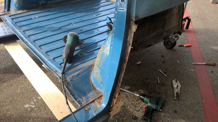

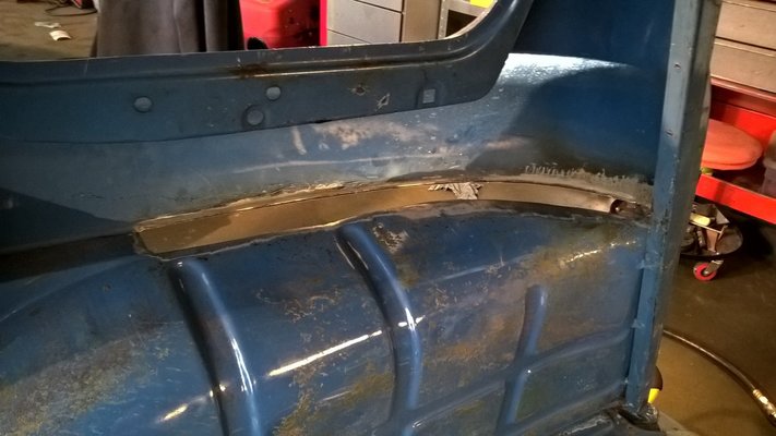

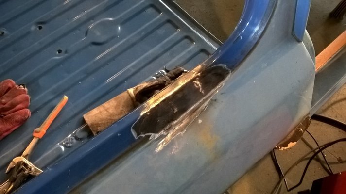

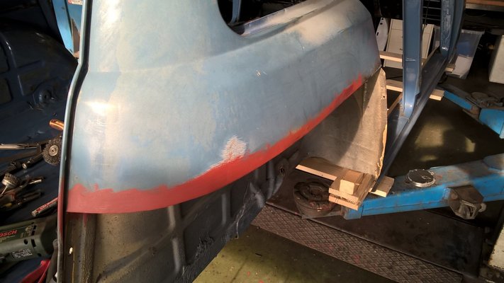

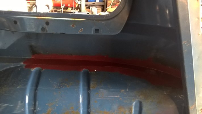

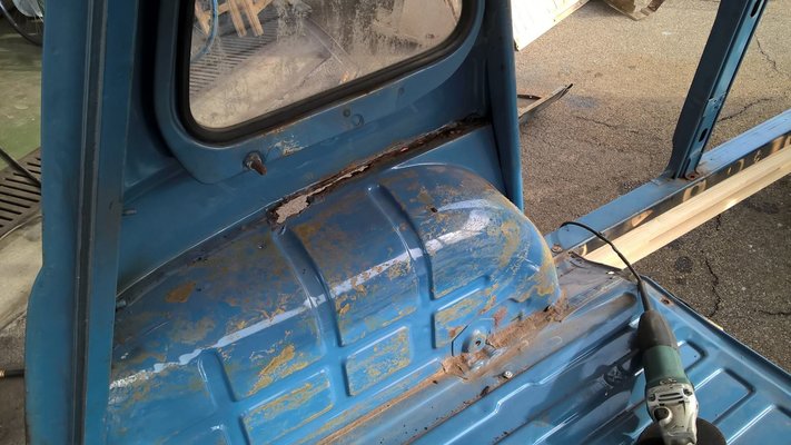

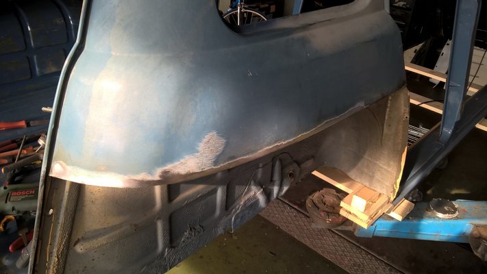

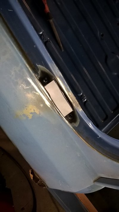

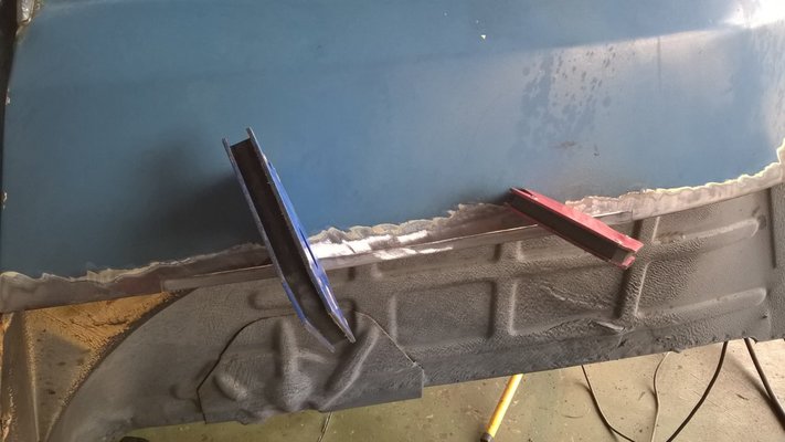

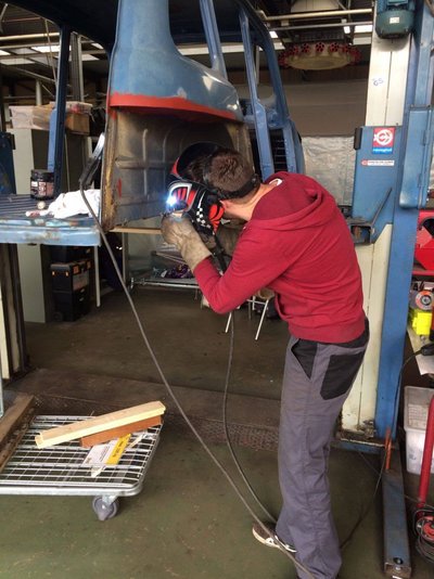

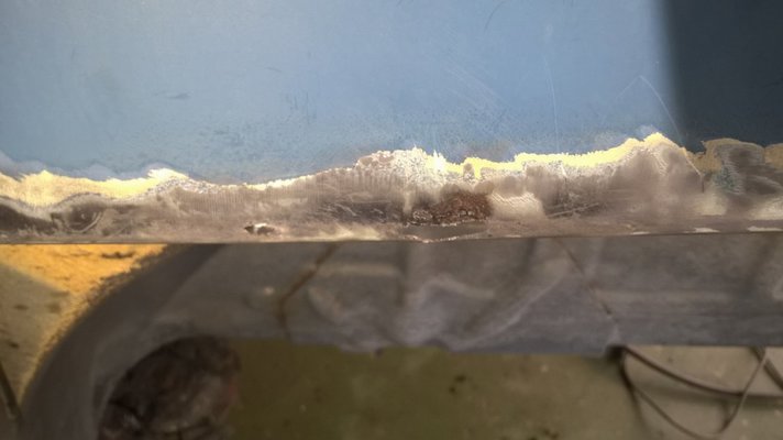

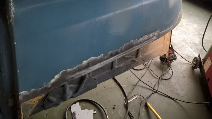

Well, unfortunately the other side was worse, aargh, so I had to spend much more time on it. First cut:
WP_20170401_12_08_54_Pro.jpg WP_20170401_12_09_02_Pro.jpg WP_20170401_12_48_29_Pro.jpg WP_20170401_13_07_10_Pro.jpg WP_20170401_13_40_14_Pro.jpg WP_20170401_13_44_33_Pro.jpg WP_20170401_18_14_12_Pro.jpg WP_20170401_18_14_21_Pro.jpg
It was a long day :welder:
Now I need a beer:drunk::laughing::laughing:
