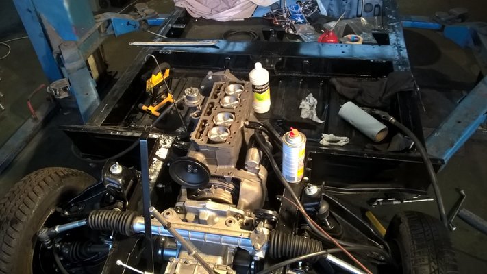

I did at first mistrust the paper seals which need to be put under the liners. Last week I filled the engine with coolant to check if there are any leaks. Well, it did leak, fluid went through the engine to the carterplug. So today I disassembled the engine again. :doh:
I have now the liners & pistons out of the engine again, and for this time I must do it correctly. With the paper seals the difference in height liner - top engine was clearly not enough. I read that there are also copper and compiste seals should be available? I haven't found these yet on the internet (well, just come home, my search need to begin to be honest :)) That seem to me a much better material to use as a seal?
Any advice, tips?
Well, one positive note. Better I did checked it. What would have happend when I first started the engine? That would have been much worse...

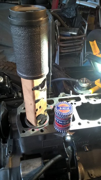

1) Polishing the contact area of the engineblock and the liners with grinding paste.

Today I did some polishing on the contact areas. I think that these are much more smooth now then they used to be. I used the old liners with grinding paste. It was a good work-out :rolleyes:
After grinding with paste left on photo

Hello Jurjenz, I can see why you had a leakage problem. The paper seals will never do their job with all that sediment.
All the seats of the liners should look like cylinder 1.
No.2 is nearly correct, you need to do a bit more work there on the right hand side.
I managed to get down there with a wire wheel brush fitting on my drill and it cleaned it off very nicely.
