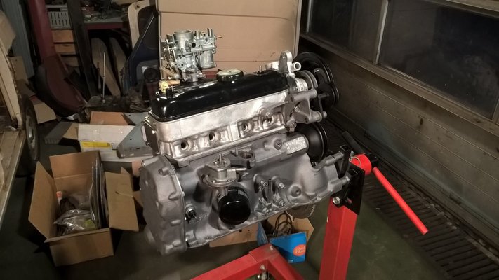

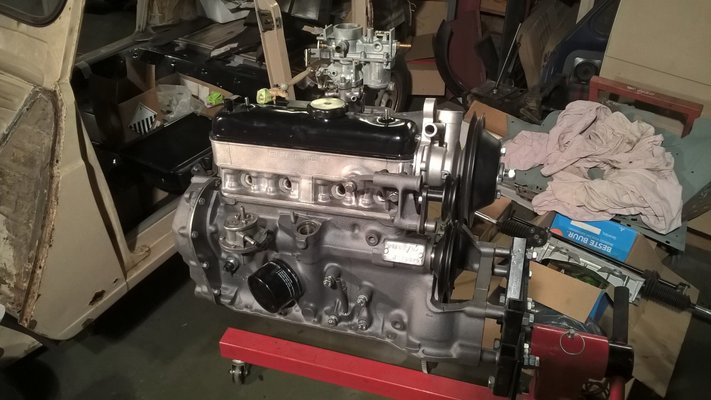

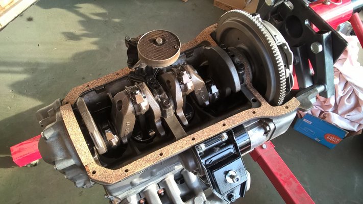

Finally the engineshop finished the last piston & conrod! So I started working on re-assembling the engine.

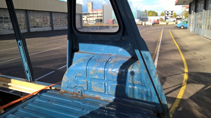

Yesss, I picked up a new body! Still some minor rusted spots which need to be weld, but not that serious compared to the other body, oh yeah..:)
WP_20161106_12_17_45_Pro.jpg WP_20161106_12_17_59_Pro.jpg WP_20161106_12_18_11_Pro.jpg WP_20161106_12_18_17_Pro.jpg WP_20161106_12_49_03_Pro.jpg WP_20161106_12_54_12_Pro.jpg
Wow that new body really does look great . Check the seat belt bolt places and in particular the bottom corners of the boot opening. Time spent here will be worth it. It's going to be a fabulous restoration Yeah :cool:!

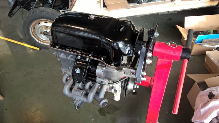

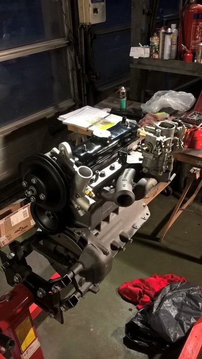

WP_20161118_15_43_03_Pro.jpg WP_20161118_15_43_10_Pro.jpg Sometimes it is so much easier when s pair of extra hands is around to help ;) I was struggling with the clutch and gearbox to line up correctly. When it did, and was bolted together, I noticed I forgot the clutch lever, o no. Had do to it all over again :doh:
But after some struggle, it all fitted very well and the engine is back on the chassis!
12109951_1679851572248692_2802836556236923439_o.jpg Me almost one year ago!
Ps. third photo above is not my engine, (uploaded wrong photo)

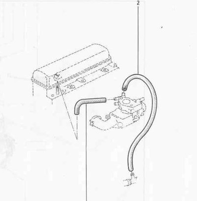

Question, where does this coolinghose connects to?
Cheers!
That coolant hose is unusual. Possibly someone has added it for a heated base for the carburettor.
It is indeed a carburettor base heater hose.
On the engine head there's a small pipe. From there comes the connection to the carburettor base the hose on the T piece is connected to the carburettor to.
In the background on the right side of the engine head you an see the little pipe to connect to.
Thanks, didn't knew where to look for. Founded in the manual.

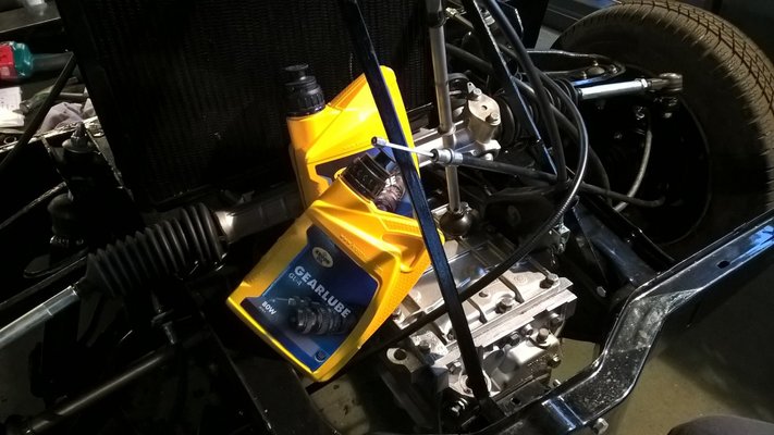

Hi guys! It´s well over a month ago since my last update. I have been busy with holidays, work, friends & stuff. This week I'm off from work so I can do some work on the renault. Mostly it's now about the small stuff, adding new fuellines, finishing the brake lines, etc.
Today I placed the driveshafts and a new alternator.

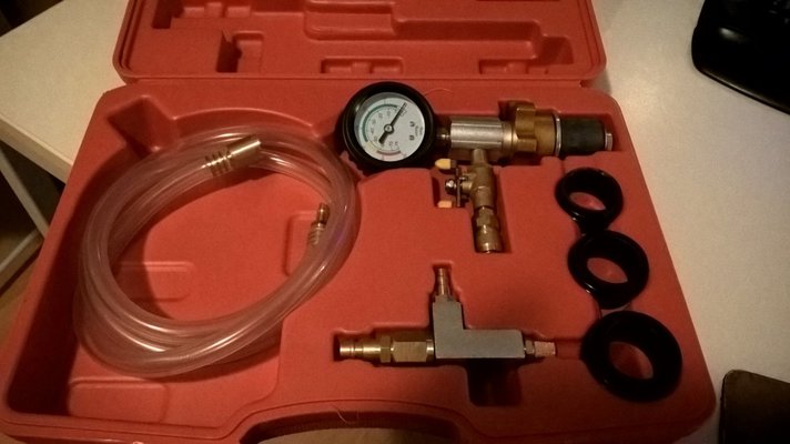

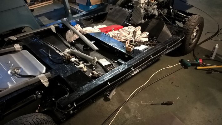

Today I attached the fuel hose to the chassis, bought myself a little present: coolant vacuum kit, and I bought some rubber hoses for the carburator.
Jurjenz, Thanks for those excellent images which makes things far more understandable (to understand) without all of the tinware in place. Why the foam pipe wrap along the chassis? Presumably you'll be using much thinner foam when the time comes for the bodyshell to go on?
