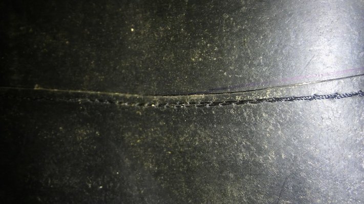

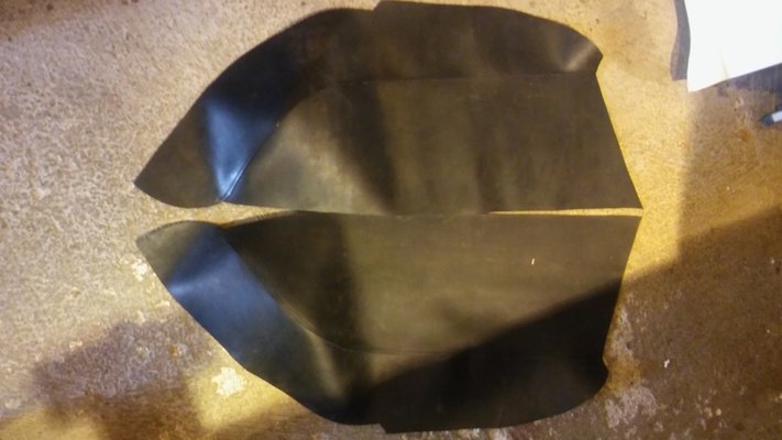

Petak those wheel arch rubbers are looking great. Thats a complicated thing to make compound curves out of flat material!
My arch covers are torn - so making some in this fashion would be better and allow a bit of room for sound proofing too.
Thank you JonathanT
I have made template from old wheel arches rubber mats out of nylon (few trash bin bags are spend).
Still have those templates.
Templates are bigger (cm or two) than old mats.....just in case....it is easier to cut rubber afterwards than to add it ;)
I have used 2mm rubber with reinforcement in the middle.

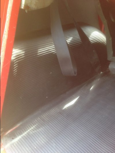

But don't all R4s have rear wheel arch linings as standard? Mine does.
No?! Show us !
Sharn't! No I photographed the inner wheel arches this morning but (as usual) cannot post images here. Facebook, email, messages, OK, but not forums. But basically they are ribbed rubber just like the rear mat.
Doh wires VERY crossed sorry Petak for all this in your thread.
Yes Paul N all R4's that I know of have those ribbed wheel arch covers within the boot. Or at least they should. I was referring to wheel arch linings on the underside to stop mud splattering up the crevices under the wheel arches to prevent future rusting. Malcolm has a whole feature on this in his restoration pages
