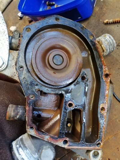

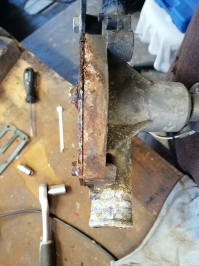

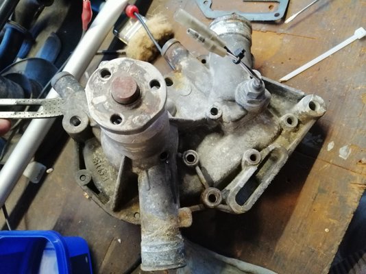

But did pictures waterpump that was leaking around gasket.
And it was full of antifriz cristals.
Inside pump is in good shape. Spinning easily and without play. I am going to put new gaskez and put it back on the car.
I made autocad drawing of the waterpump gaskets if anyone need it to make his own gasket let me know. Can send it via email.

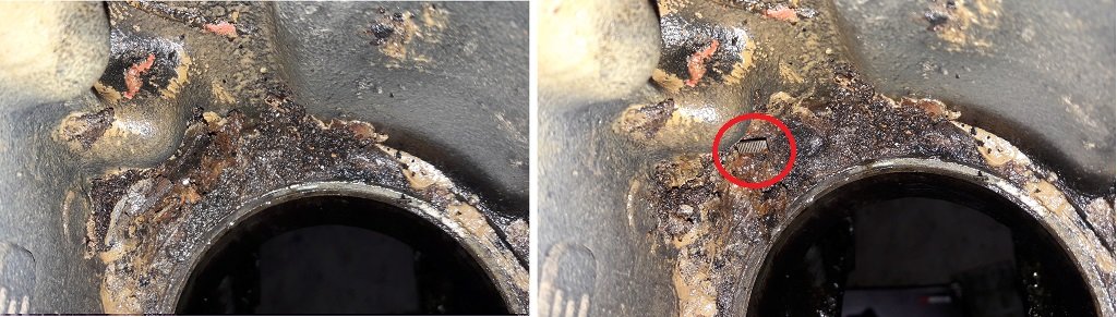

Maybe the block was empty or maybe it was clogged. That perticular spot is a know Cleon engine cylinder 4 hotspot, almost no circulation and always a buildup of hardening sludge.
This picture shows the buildup in my Cleon engine, on the left side the rockhard build up where the drainplug resides, on the right side you see the tip of a small screwdriver (red circle) sticking threw the sludge.
Reading your story about the mud and other particles, maybe there's a build up of debri and sludge at the drainplug location
Very likely it is cloged Jdew as you say.
But i do not know of i can do something about that unless engine is opened and removing cilinders.
Maybe an extreme coolant system flush which removes scale, rust and deposits might do the trick so you don't have to open the engine.
Opening the engine is the last resort when in doubt.
