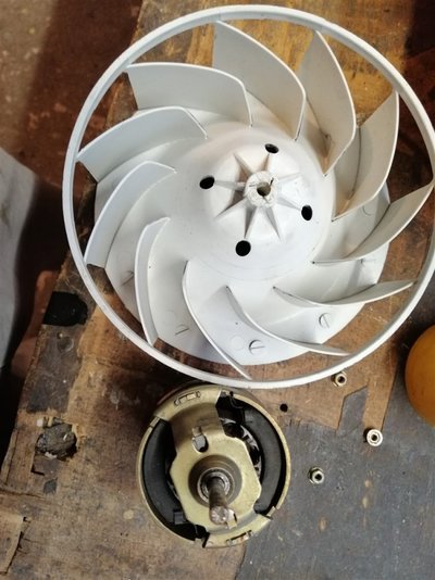

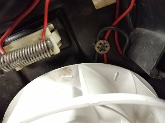

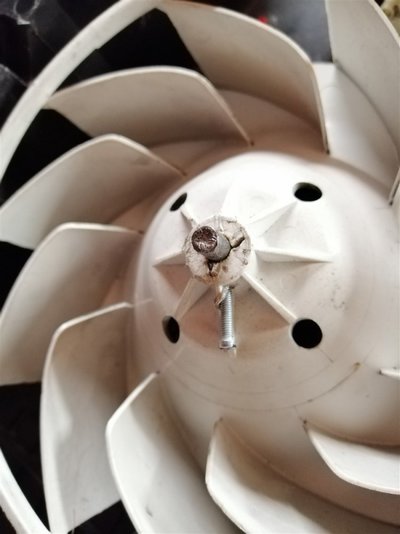

As everything was out i wanted to see if something can be done with squeaking sound of my heater ventilator.
It turned out there were two problems.

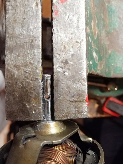

First, plastic ventilator body was slipping at vent engine shaft. Security washer did not hold body on shaft.
So i drilled small hole and made M3 thread on vent engine shaft
And put M3 screw to secure ventilator on the shaft
Now when sqeaking was shut up i noticed rattling sound, which was coming from vent body hitting wires
After that it was silence. :D

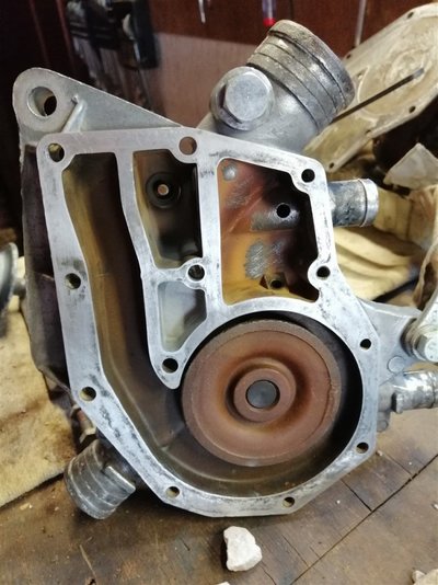

Also take of rest of the gasket on waterpump body.

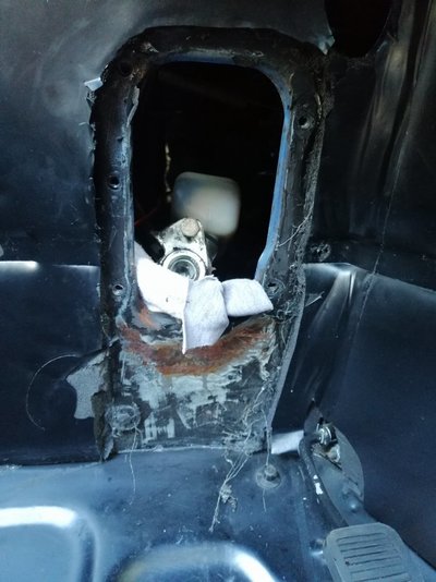

When you find out that your brake master cilinder leaking brake oil inside the cabine.
It is question for how long this is going on.
What can you do?

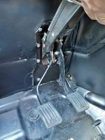

Well, take it all down.
Get rid of that surface rust.
Do the same on steering column and pedal assembly.
Getting rid of rust, clean, repaint, and put back in to the car.

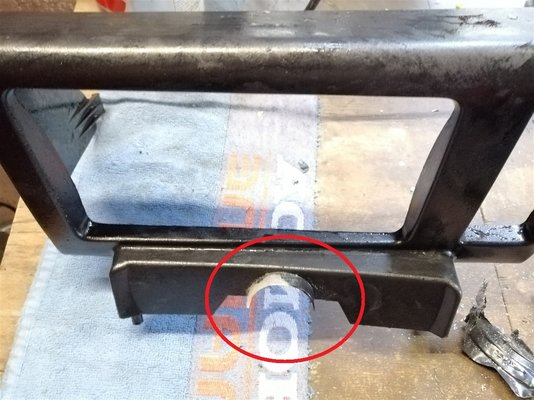

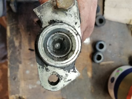

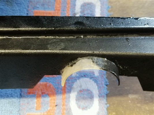

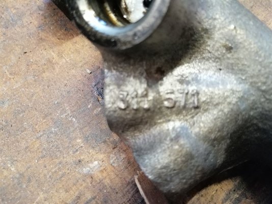

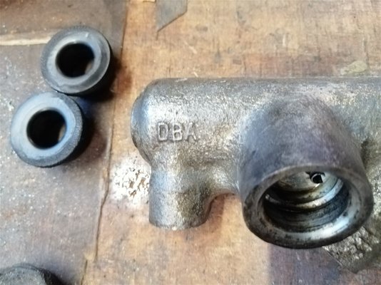

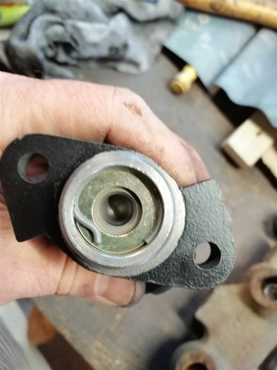

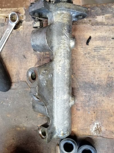

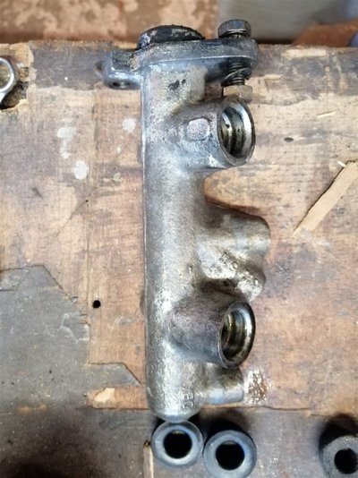

Took down brake master cylinder and compared to one i have bought (ATE) and find out they are not all the same.
Here are pictures of one that was on my car. probably same one that was installed in factory.
There are some letters and numbers cast in it. DBA and 311571

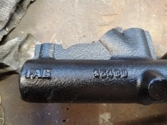

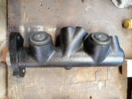

And here are pictures of one i have bought. It came in ATE box as ATE part (part number 24.2119-0915.3) but on it are casted letters and numbers FAG and S5480.
According to ATE catalog it should fit my car ( that is why i bought it) but it is looking little bit bigger than original one. Cast is little bit bigger. Brake line and fluid reservoir connections are the same and mounting points in pedal assembly are the same. They are same in length also.
Different is top side where pedal rod is pressed to.

My question is
Will my brakes work normal if i put ATE brake master cylinder instead of my old one?
Are they actually the same with small manufacturing differences?
Thank you!
I think our GTL's have a 19,05 mm inside diameter master brake cylinder with 3 lines.
So as long the old and new master brake cylinder inside diameters are the same then the brakes will work normal.
TX Jdew.....
According to ATE online catalogue this master cylinder is 19,03 in diameter and 3 lines M10x1
Obviously outside dimension differences are not critical and can well be due to different manufacturers - DBA (Bendix) and FAG. What matters is inner diameter so you will not tell any difference in braking. In fact this 3-outlet master cylinder was only available in 3/4" diameter, so impossible to fit an incorrect one.

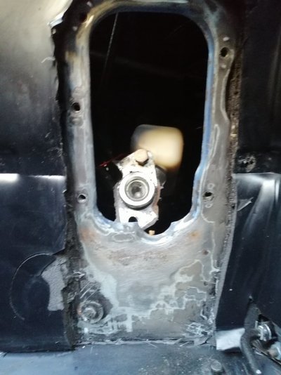

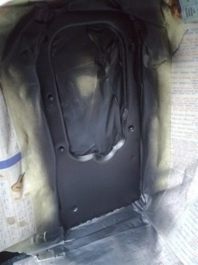

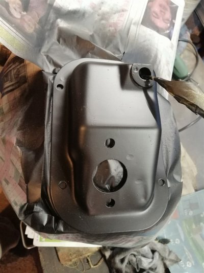

Mean while i have painted pedal/master cylinder bracket and left it to dry/harden for two days. Same is done with firewall.

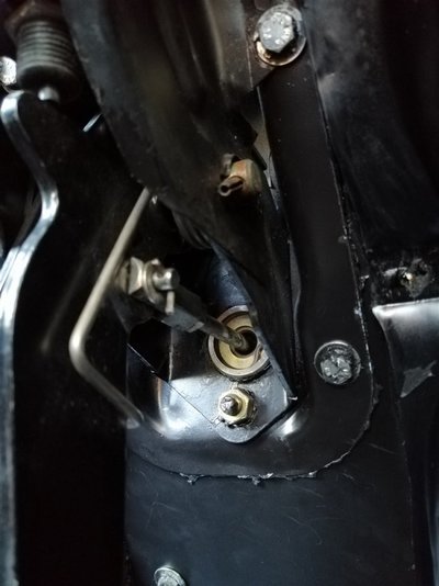

Mounted steering column in place

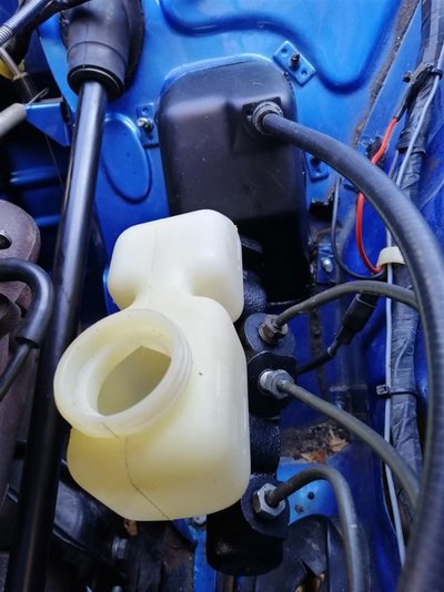

Struggled to fit brake master cylinder as it is long way around to hold bolt with one hand while placing master in places and putting nut on bolt with other hand. Eventually it is in place
From inside
Poor a lot of water over this parts to test water-tightness. Changed some rubber grommets as one on choke cable was not watertight.

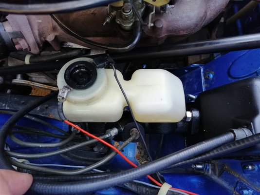

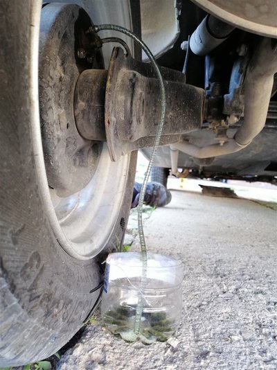

Bled brakes by myself ( you can see my foot in front of wheel :D)
Youngest son helped me at the end by pressing and holding brake pedal pressed. To him it was fun and to me it was crucial.

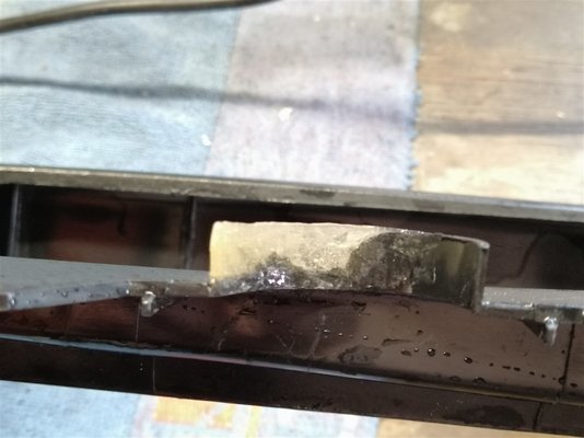

Repaired instrument cluster cover as it was broken for long time but did not know how to fix it.
On one facebook DIY channels saw that it can be repaired with epoxy resin. So decided to try it and see if will work.
It worked better than i tough. After mold is taken off tidy it up with small dremel electric tool
Painted in black with sonax renewal for black plastic
