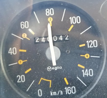

We are counting km unstoppable.

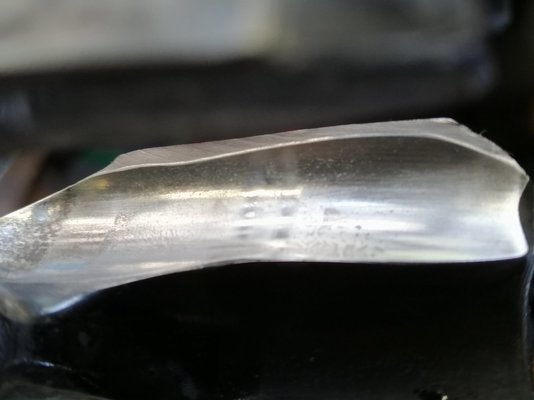

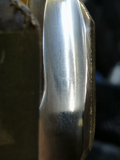

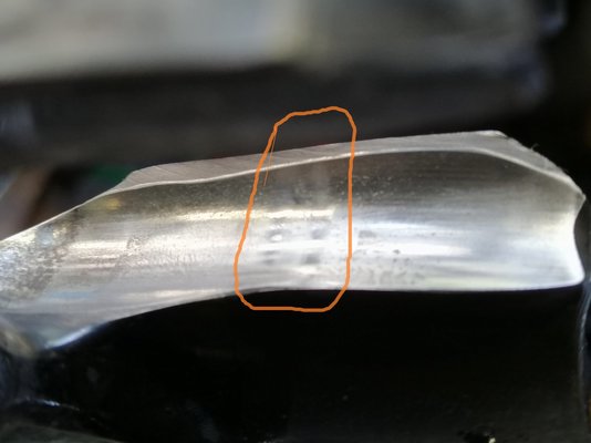

Tried to polish grooves on wheel side joint as recommended by guy who is living out of fixing R4's

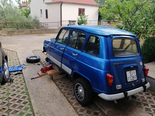

hope today will find time to change one driveshaft to see will there be any difference.
If this does not work out good will send them to guy who is reconditioning driveshafts.

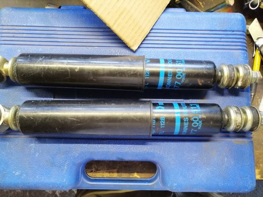

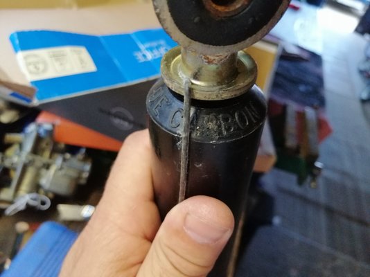

Meanwhile, i am looking for spear parts (new or good used one) so recently bumped at brand new, unused, original Renault, DeCarbon rear shocks.
They are going straight to the car as Monroe that are on car now are gone. Some time now i feel that rear wheels are not holding road good as they did when were new. It took 5 years and 50tkm for Monroe to fall apart.
If someone have front DeCarbon shocks for sale please let me know!

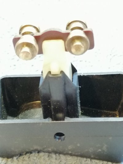

When i turn key everything is OK. Bulbs light up and fuel gauge get current and needle jumps. But in the moment i turn key more to ignite starter star to crank but fuel gauge needle fall down to zero. And i can crank it long time without start. Yet again, when i turn key back (actually it turns back it self, second you leave it) car starts hardly because there is to much fuel inside cylinders from long cranking.
