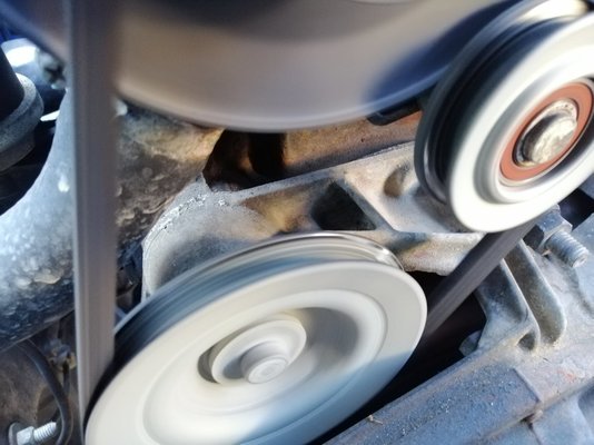

Also checked waterpump which i renewed year ago (put new gasket on old waterpump) but under it was dry

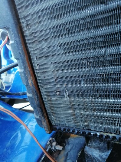

Rusty side of radiator

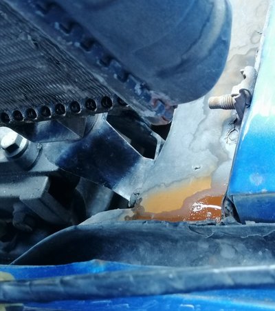

And small pool of cooland under radiator

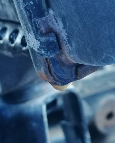

And here is drop from radiator
So new radiator must put instead of this one.
