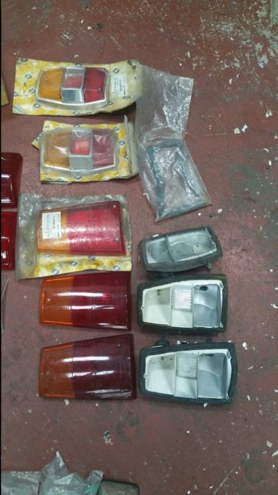

New computer meant I missed that post! Is anything still available? I have a much better idea of what I need now so I'd be far more willing to throw some pictures of the queen at you.
