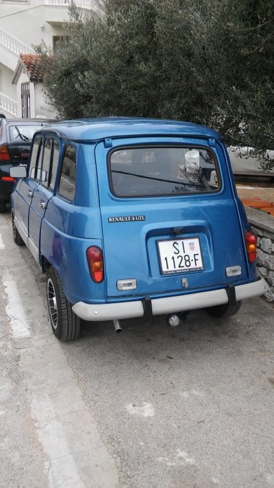

Today i have BIG news.
As always picture will tell more than words.
First long 25km made today. Do not count those few made in town.
Driving nicely!
Aldo need to get back feeling for swinging while driving especially as strong wind (bura) is blowing right to you.
Found out few details to take care of.
Strong pinking noise when driving uphill or catching speed. Actually whenever throttle is pressed more than it is needed. Soon as i pull leg up, pinking stops.
Some rattle from engine bay is coming when i get to high revs. Can not tell is it just stronger pinking noise or something else is rattling.
My speed dial is not working correctly. Counting kms nicely but needle is not getting up or down constantly but jumping from speed to speed. From 0km/h to 40km/h needle is on 0 then suddenly jumps to 40 then jumps to 60 than 80 and then it looks like it is working fine till 100. backwards is the same. When i stop needle is at 35 km/h. small knock on plastic and falls down to 0.
And some noise is getting form clutch (or some part in that way) when i am slowly releasing clutch. Just first few cm, after that no noise any more, and no noise while i am changing gears while driving (or i can not hear it)
Hope that both problems will be solved with tightening cable.
And my fuel gauge is not showing correctly. Yesterday I top it up and needle is shoeing some 3/4 (little bit more)
Any thoughts about it will be appreciated.

Wow Petak what a wonderful achievement . A few minor issues to sort but back on the road. That must feel great and you deserve that with all your hard and meticulous efforts. It looks s dream . Thank you from lots of us (I suspect) For all your comments of how you overcame problems and helping others do the same. Your local roads look delightful. Sunshine and space to explore with all your family ...ENJOY.
