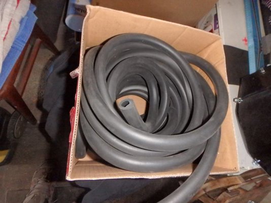

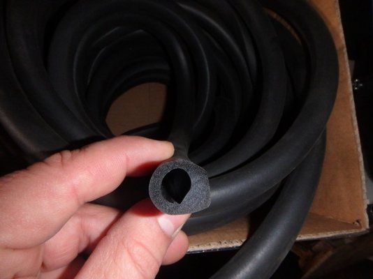

Find out that rubbers on door i have bought on ebay (link is few pages back) are not tick enough (wind is blowing on some places while drive it) so looking for original one.
One guy here (in Croatia) is selling rubber for 4 doors bought on franzose.de
Believe that will get deal with him
For 5th doors i will contact angel from this forum.

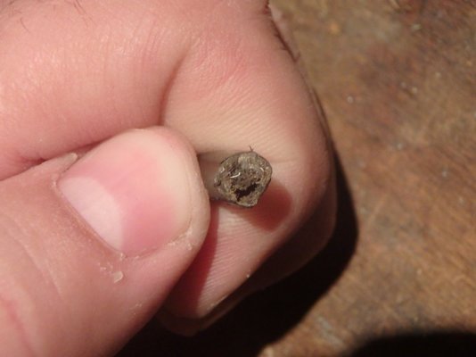

Take fuel tank from car and tried to blow pipe (was thinking that some garbage form tank was stacked inside - aldo it was minor possibility as i have cleaned tank form inside) but no luck.

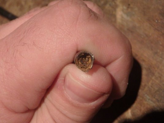

Then i pulled out fuel line and find out where problem is.
My strong, durable steel pipe got rotten form inside and rotten so heavily that fuel could not go thru.
Some pictures of that rust

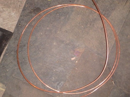

Solution was to go to shop and buy 6mm copper pipe and change it.
Here it is
Now i have fully working fuel line that brings fuel to carb.
Aw more effort! Type of pipe i beleive is Kunifer pipe which I gather does not corrode
Me neither Mojobaby.
Not even slightest suspicion on the pipe. but at the end that was the problem.
I still can not believe that it has rusted just from moisture in the air. It is mystery to me.
Yes JonathahT
Cunifer is right pipe. It is actually stronger alloy of Copper (Cu - Copper, Ni - Nickel, Fe - iron and little bit of Mn - Manganese) best material for ships pipelines
But it is more expensive (cca 3xcopper) and you need to order it. Can not go to shop and buy 3,5m
But copper is just good enough and will do the job as good as Cunifer

Got rubbers for all doors from angel....
Tried to glue them on door but that was total fiasco
Have right adhesive for the job but i could not press rubber with clams to stay in place while glue cure. And it takes time to cure. 2 hours at least, but it would be perfect over night.
glue that i am using
As i see it now i will need to dismantle all doors one by one and glue rubber and then get doors back on car.
Does anyone have some smart solution so i do not need to remove door off the car?
Any suggestions will be appreciate!!!

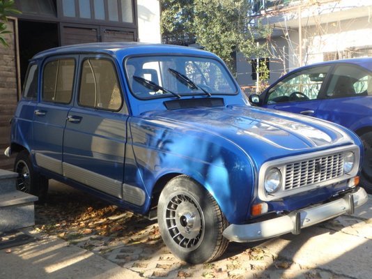

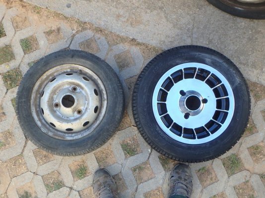

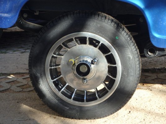

Also bought some new tires for the "car"
SAVA Perfecta (Slovenian brand under continental brand) 155/70/13 75T
and out them on THE wheels.
Comparison old tire (135/70/13) and old rim with new tire (155/70/13) and new rim
Old rims are going for soda blasting and freshening up (powder coating). Will be used as winter wheels with 135/80/13 tire
New wheels on the car

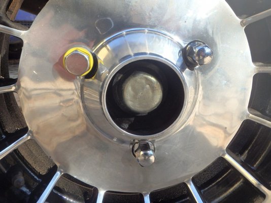

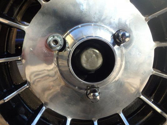

With safety lock (just to be sure my wheels will stay mine).
Had to work on those safety lock nuts as cone was not good for rims. Lathe was working slightly.
To get whole picture here are some pictures :D
front of the car need to go up

I use a different kind of glue, to be applied on both sides and then quite adhesive.
You can try keeping the rubber in place whike curing with short pieces of paper masking tape. ..
Can you tell me what kind of glue you use, Azazello.
Will try with masking tape. Thank you for idea!
I use contact glue, that needs to be applied to both the door and the rubber, then left to dry before fitting the rubber to the metal. With this type of rubber I found it's better to rub it slightly with 400 grade abrasive paper at the sides where the glue is to be applied, in order to remove any residues from manufacturing processes.
It's way easier if you remove the doors from the car.
