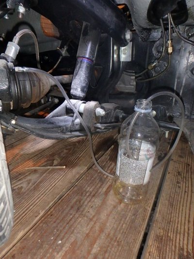

Yesterday fixed position of the dizzy, now it stands like it should. But car would not start. To me it seems like some fuel problem.
When i first started engine had same problem but then tried to clear pump from system and poor 0,5liter of petrol into bottle and stick hose from suction side of pump into bottle.
Pump took some 1 dcl of petrol and engine started. But when i connected hose back to the petrol tank car did not start.
Need to do something about that.

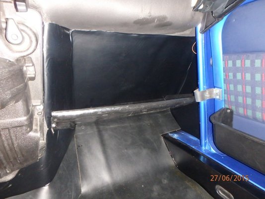

Worked little bit on inside

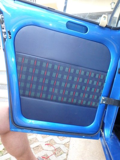

1. Shelfs
2. Drivers in place
3. Passengers in place
Had big trouble mounting them because of insulation. They are tight fit even when there is no insulation, than you can imagine what trouble i had to put them in place, especially as i did not know where bolt hose are. So took nails and push them form out side to get some guide.

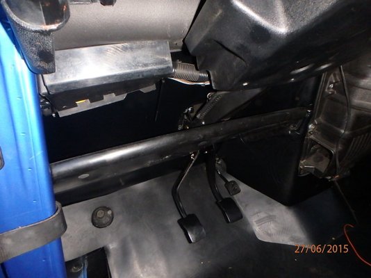

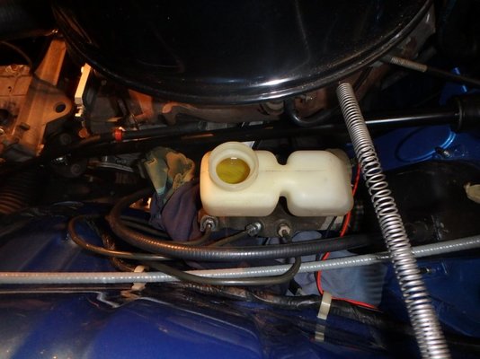

4. brakes
Had trouble here also. When i have put master cylinder in car he was working fine, but now few mounts later piston got stucked inside, and i could not get brake oil into calipers. So had to change whole master cylinder.
After change everything went alright

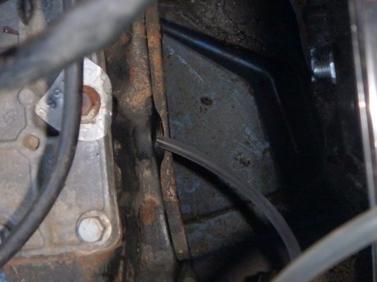

Poor gearbox oil
2 liters will be enough
to easy job and not to poor oil all over made my self help
After a while oil came out of the gearbox. That is sign that you have put oil to the top
This process was very slow. because i had small filling bottle and small hose.

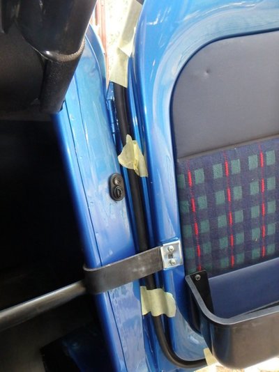

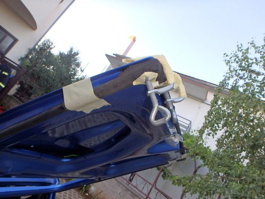

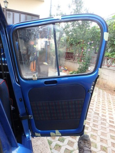

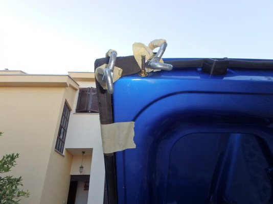

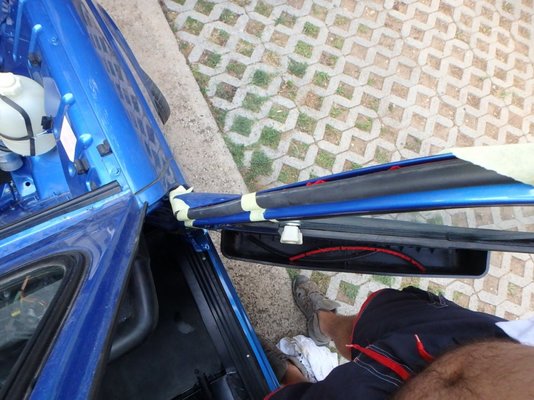

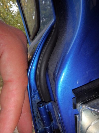

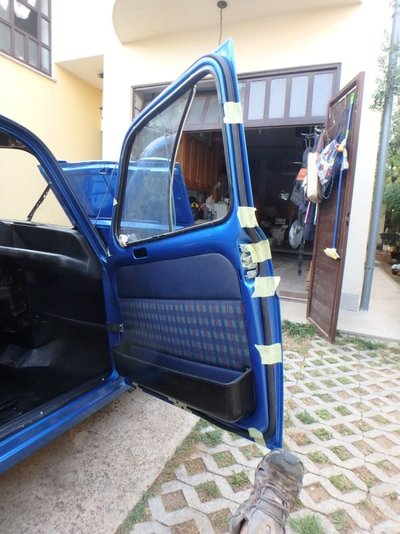

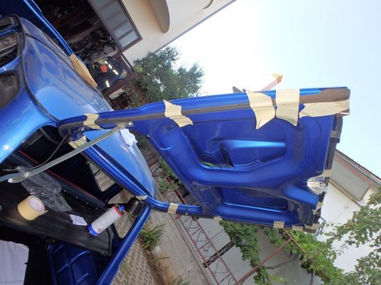

So wile oil was draining into gearbox i have started to put rubbers on doors.
one that i have bought on ebay for small amount of money.
They are not original but close enough.
Wanted to see how they will fit and how god will prevent air and water getting into car

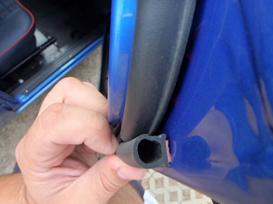

This is how profile looks like
Positioning on the doors
rear doors
On rear door it fits pretty good
But on front doors there is some gap at the same place shown on this picture. This is picture of the rear doors.

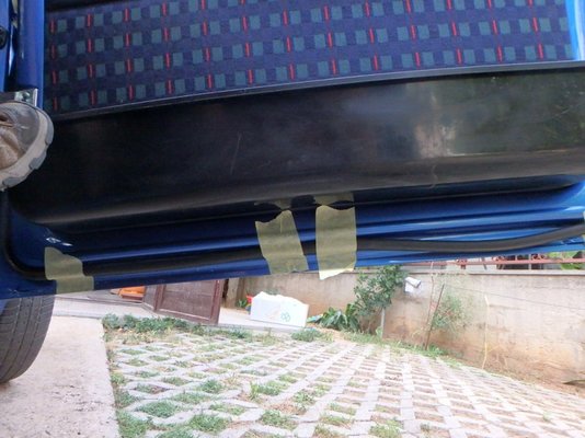

Also booth door.
Have kept original corners of the rubber and glue them back
Upper part of the rubber is fitting nice and believe it wont get water inside, but lower part is to small and need to find different solution
Used this glue for the job.
It seems to me that will hold good but problem is that you need to left glue cure for 30 min at least. I have left it over nigh (almost 24 hours)

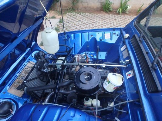

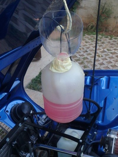

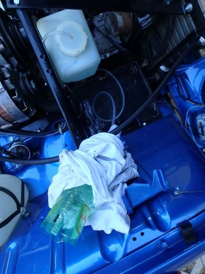

Next job was cooling liquid
Preparation for job and not messing all around.
Mixed 2 liters of antifreeze (-80°C) and 3 liters of distilled water.

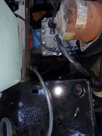

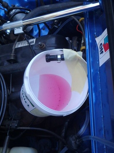

Turn heating on ( to red dot), open bleeding screw and cap on radiator.
Start to filling system
After water reached top of the radiator close cap and keep filling until you get water coming out of the bleeding screw
When you get nice and steady jet of water close bleeding screw, position expansion bottle on her place and tap it up until you reach MAX line on bottle. That is it.
You can then start the engine, watching ventilator to go on, and once more open bleeding screw to let some residual air out.
You are god to go.

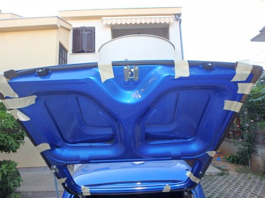

I think you can buy the boot lid lower seal moulding from the R4 specialists like Retro Passion. The door seals look good with the big hole in the middle. A lot of the reproduction ones are too stiff.

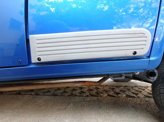

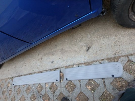

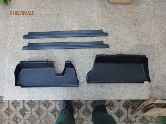

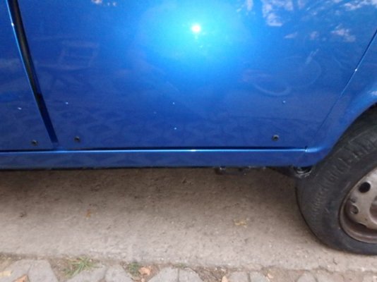

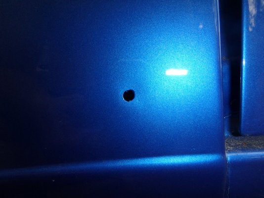

Side plastic protections.

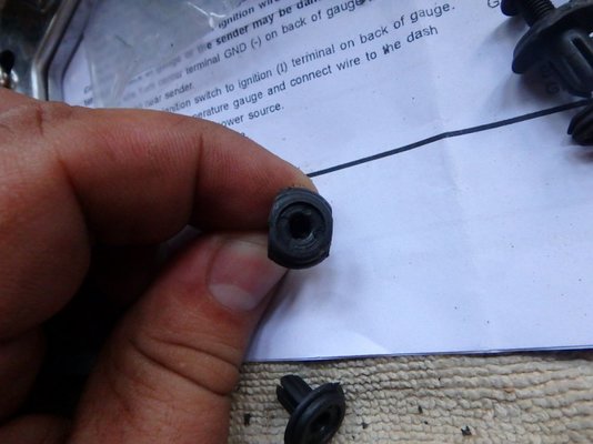

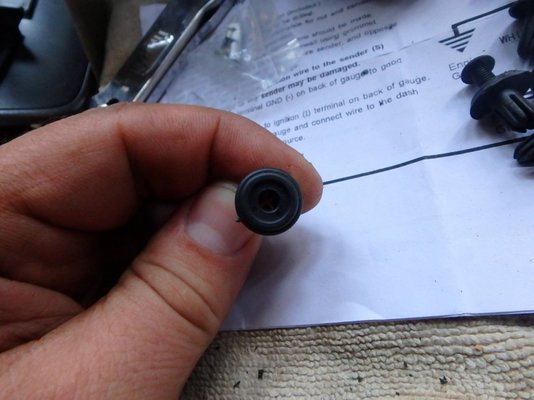

As i could not find original plastic clips for screws to use, found something that will do the job. BUt need to trim clips little bit to fit.
Original shape
Trimed

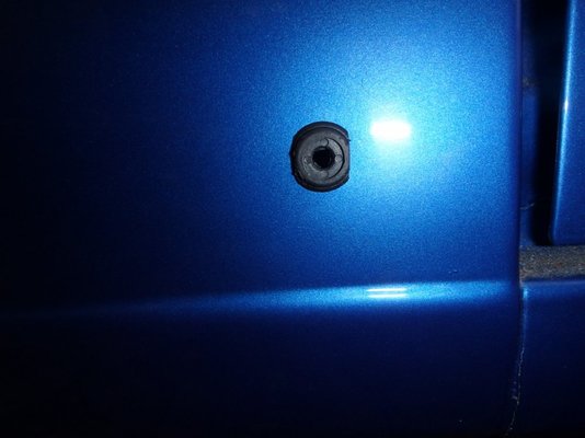

HOle for plastics
Clip inside
Plastics
One in place. Used fi3,6 16mm long screw
Plugs for holes will go used one for now....but planing to buy new.

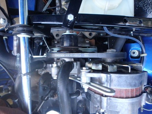

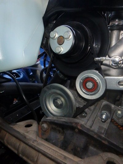

Time for belts
Used continental brand....Will see how will work
Alternator belt
Waterpump belt
When engine was running i have noticed that tensioner pulley is wiggling and there is some squeaking sound so probably did not put bearing inside correctly. Need to fix that.

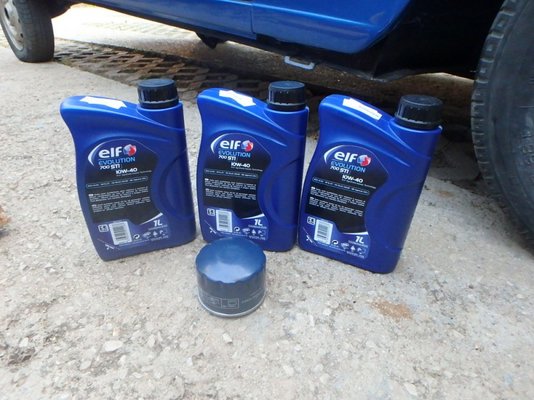

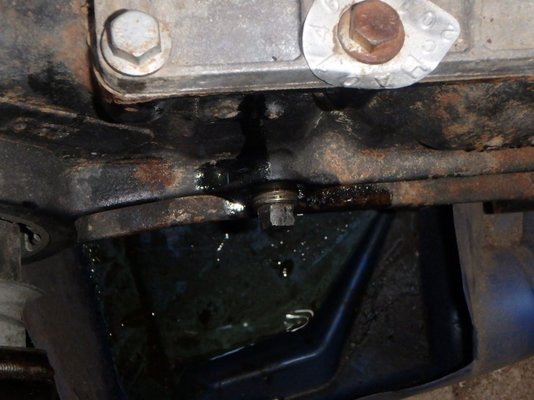

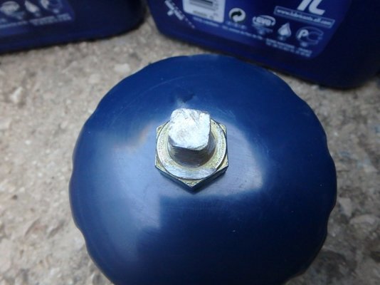

Fill up engine with oil
Oil filter and hand maid tool for drain plug (already on the car)

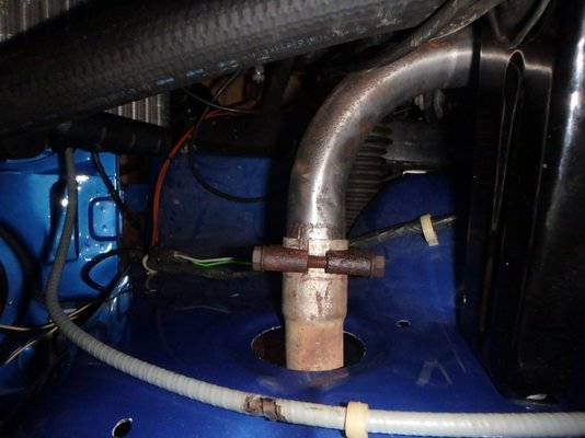

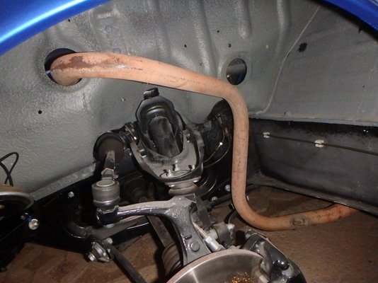

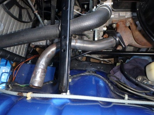

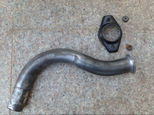

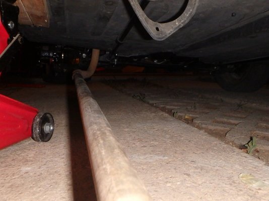

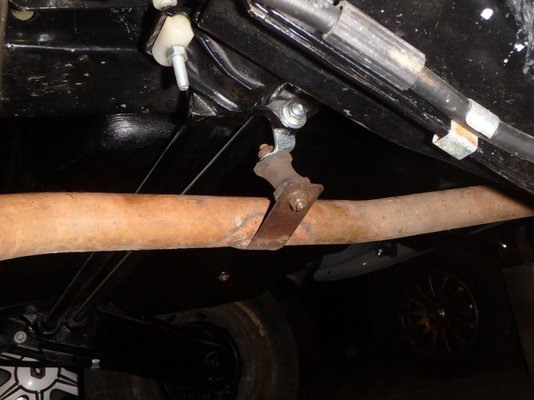

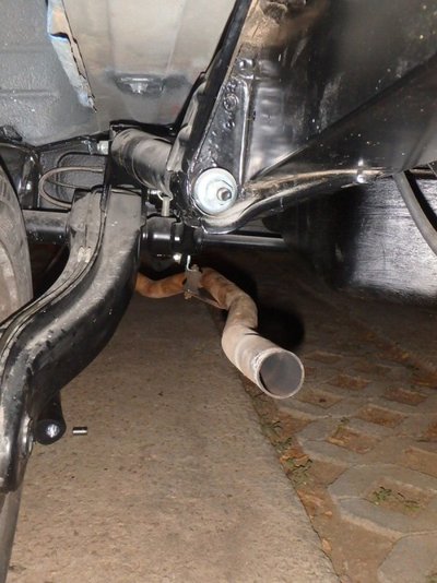

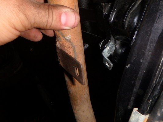

Next step exhaust.
Will use old piles, and new silencer and rubber mounts
exhaust from start to finish
Look from behind without silencer. I still need to buy one.

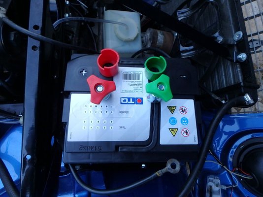

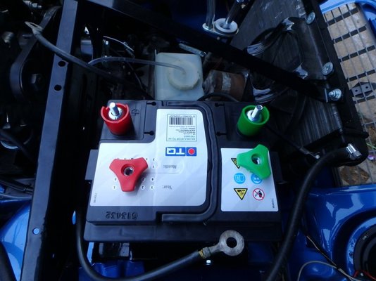

And last thing battery
Used local shop brand TQ 44Ah 420A (FIAMM is actually producing battery for shop)

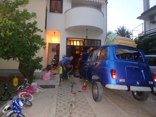

And one picture so that you can see how many helpers i have. Oldest son (7) is taking the picture
Thank you malcolm....do you know is it hollow tip?
This was test for me and rest of R4 lovers to see will cheap ebay rubber make it good or it is not worth buying.
