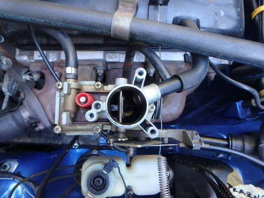

Few days back i have received small box with treasure inside
two completely refurbished, tested, and pre-adjusted Zenith IF28 carburetors.
Yesterday spend all afternoon to change it
Old one
removed......notice big soot deposit around carburetor stand.
Also managed to get vacuum pump.....used but in good condition
Taken from this distributor
Inside
Cleaned in diesel
Adjust point again and started engine adjust idle little bit
Went to my friends garage for fine tune with strobe light.
Noticed that sometimes spark is passing thru hole in dizzy where wires from cond and coil are conected.
Here
Get home and change that bolt with insulator from second dizzy that i have for parts (one i have taken of vacuum pump)
But this morning can not start car.
Spinning nicely bud nothing is happening.
Need to check spark.....
But it is strange as everything is as it was yesterday afternoon.
